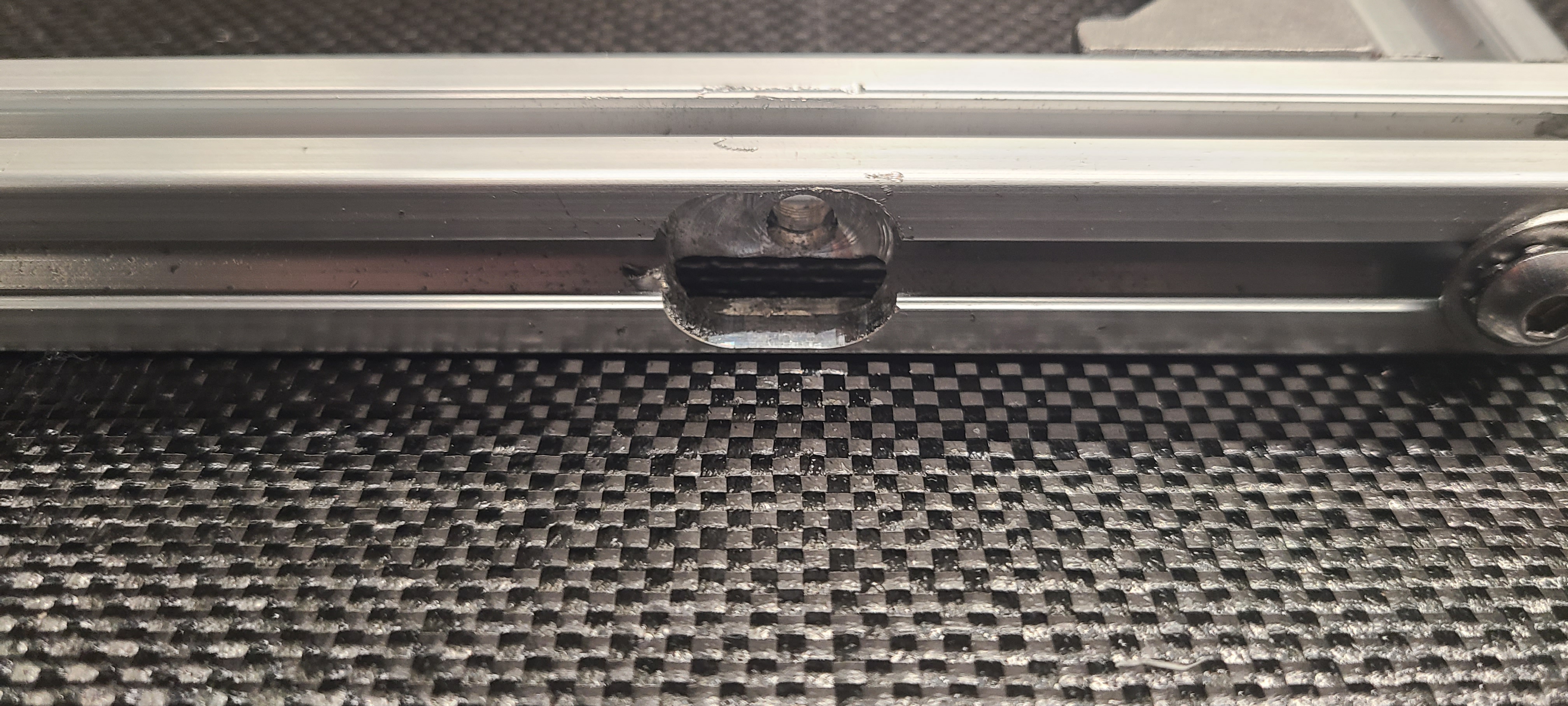

in the bottom of the Thule roof rack bar, where the Thule towers hold the roof rack bar, I slipped in bolts in the same track of the roof rack bar. the bolt goes through the 2020 and the nut is recessed in the spot I milled out here.
